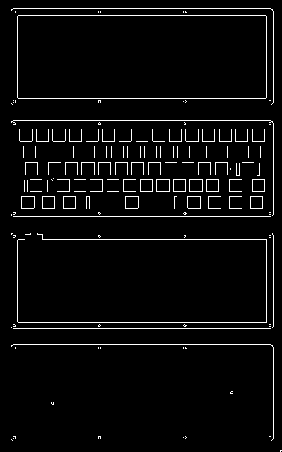

Following my step by step guides I'm here to offer you the chance to laser cut your plate or complete case in Aluminum and/or Stainless Steel.
Please read carefully
  • This is NOT a Group Buy for a few plate designs that have to reach a MOQ. We do not have fixed layouts, you can laser cut your very own design. For this reason your plate won't be cheap, but it might be your only chance to have your custom design that nobody else would ever use.
  • The trick to spare some euros is to fill a whole sheet of Alu and Steel. One sheet is 3000x1500, the better we fit it, the lower the cost for everybody. The thicknesses we are going to have are the followings:
    • Aluminum 1.5mm (mainly for plates)
    • Aluminum 3mm (for the sides)
    • Steel 1.5mm (for the case bottom and plates)
    • Steel 3mm (ONLY if there's enough request for it)
  • How to choose the material. Aluminum is very light. Steel is too hard to be used as a plate (in my very humble opinion but YMMV), my suggestion would be to build the plate and the sides in aluminum and the bottom of the case in steel to add weight.
  • If you want you can have the sides laser cut in acrylic, but you have to take care of it by yourself. This GB is not for acrylic.
  • Metal is untreated. It's not anodized nor treated in any way. Bare, raw, metal. See how it looks here and here.
  • Believe it or not, aluminum costs almost twice as steel.
  • You can laser cut anything, not just case/plates (fan grills? door bell frames? chastity belts?)
Alert! This GB is not for boobies!
Designing a new plate/case is no easy task. Each design would need to be tested and prototyped. Making few small mistakes is very easy and you might end up with an expensive piece of useless metal. You are responsible for your own design. I take no responsibility on your design even if I help you with the CAD file.
How to place an order
The Brownfox is a keyboard that I already prototyped and it turned out pretty well. So small changes to that layout should put you in a safe spot. Here enclosed you'll find the DWG for that keyboard. You can use it as a starting point.
Note that the keyboard has 6u spacebar with not standard mounting points and distance between keys is 19mm (instead of the suggested 19.05mm because in my experience it doesn't make any difference).
I'm also going to post the layout for an ALPS based plate.
Post your ideas/requests or a mock up of the keyboard you want in this thread and I'll try to help you out refining your design. I also hope that other keyboard gurus might chime in and help me with tutoring. Once your design is finalized it will be made public and others may use it.
All DWG must be in MM, I don't want to see nonsensical inches :P
If we have few participants and we do not fill the sheets I might cancel the GB.
How much is it going to cost?
The cost of your keyboard varies depending on material and number of switch holes. Note that pure square holes are cheaper than the ones with dents for easy access to the springs. For this reason I'm going to make a formula to calculate costs based on various parameters.
Once all layouts are finalized I'll send a quote request. The cost for a full case might go from €50 to €150 for a sub TKL + shipping. Tracked shipping is: €12 for 500gr. €17 for 1kg. €22 for 2kg. To give you an idea, a 100% steel case weights about 1kg. Do not place your order if you are not prepared to pay that much.
Again, this GB is for prototyping and/or to have your very personal design in a reasonably short time. If you want it cheap you should look for the GH60 or wait for 7bit HyperMicro.
Deadline
August is not a good moment to place orders. If we can have this sorted out quickly I'll try to send the quote request in 10 days from now and we should have the plates ready in another 10 days. If we go too deep into August we will probably have to wait September.
Have fun prototyping!

My layout is all done. You even laid out my plate for me already:
I'd like an aluminium plate, as I trust your advice on its superior feel to steel. But the rest of the body is a different story.
You mentioned mirror finish steel before this thread. Is that still an option? If yes, I want as much of my keyboard to be made from it as possible! Including a trim layer above the plate for the flashiest keyboard I can imagine; with appropriate tweaks to the rest of the design so it can fit. If no, then I'm still fine with matte, brushed steel. I'd prefer it for its higher weight, but if you need me to stretch to fill the aluminium sheet I can take aluminium sides instead.

Muirium wrote:I'd like an aluminium plate, as I trust your advice on its superior feel to steel. But the rest of the body is a different story.
You'll see just the laser cut section on the sides, so you wouldn't have the mirror effect. Only the top of the sheet has mirror surface. The sides should be made of plain steel anyway. The only reason to make the sides out of steel is to make the keyboard heavier, but the 1.5mm steel bottom is pretty heavy by itself (approx 380gr).
There's also another thing. Aluminum is more "workable", it's very easy to file out 1mm to fit the USB port for example. If you need to file even 1mm of steel... good luck with that :)
Muirium wrote:I'd prefer it for its higher weight, but if you need me to stretch to fill the aluminium sheet I can take aluminium sides instead.
Fortunately steel is cheaper, if you are ready to pay for your piece of mirror steel, sure, you can have it :) Please consider that I have to redesign the case (basically make it 2 mm bigger in both directions) if you want the top frame. This might introduce errors. I'll soon post the final design for your case, a good way to test it would be to print the DWG and home cut it in cardboard.
Muirium wrote:(Would now be a good time to experiment with a gentle wedge shape case
How would you do that with laser cut layers?

Muirium wrote:Okay. Could we see Steely and Brownfox sitting side by side, and, if it doesn't upset them, figures for the weight of each?
Sorry, the Steely has been predated of most of its parts in favor of the Brownfox.
The Brownfox weights approx 500gr. The browfox with steel bottom would weight 800gr I guess.
The Steely weights approx 1250gr.
Steel sides are fine if you want a heavier keyboard, just be sure to have the tools to work steel.
Muirium wrote:How much is the mirror steel likely to be (very roughly) if no one else joins me on using it? And, if I go that way, could I get a second plate cut from mirror steel itself and a mirror steel base for a little extra? (The sheet is the main expense, didn't you say, and the subsequent lasering is less pricey?)
Never had mirror steel before. I'd say €20-30 for just one frame. The frame would be 3mm thick probably. The case bottom and plate are 1.5mm, so you'd need another sheet for them.
They work more on steel than alu, so it's more likely that they have steel leftovers, but I don't know about mirror steel. It's surely more expensive than standard steel, I don't know to which extent though.

Muirium wrote:Here's a thought: 3mm thick mirror steel case bottom? Maybe the extra weight would let me get away with aluminium sides. I'd hate to make a mess of the USB port.
I wouldn't advice that... but technically speaking nothing stops you.
Just out of curiosity, why a mirror bottom? You can't really see it.

To make Steely easier on the fingers I tried to add a rubber layer to the sandwich. Well, nothing changed. Steel is bloody stiff. Nothing you can do about it. If feels solid, it looks solid and it's definitely fancier but aluminum is so much better to type on.
will this be your daily driver? if so, use alu. Is this just a very nice toy/experiment you might use once in a while to awe family and friends? Use steel.

Broadmonkey wrote:Tbh, I don't think the laser cutter carry any pre-polished (to a mirror) sheets of steel. I could imagine, it would just be a waste to get it polished before cutting, since there is a high possibility the unit will have to be repolished afterwards anyway.
the sheet comes already polished. It has a protective film on the mirror surface. The cut is clear and doesn't damage the surface, but you can see small burns on the section/side in some situations (eg: screw holes).
photekq wrote: Thank you very much and let me know if you see any problems :)
there shouldn't be any problem with your design. tomorrow I'll have a look at the DWG.

These are the layers needed by Muirium's board.
And this is the DWG.
muirium.dwg.zip
(14.41 KiB) Downloaded 365 times
Of course you need 2x the top layer and 2x the third layer.
Please triple check it. Print it 1:1 and verify that everything's fine.
Especially the top frame is extremely fit, you need to check if the perimeter keys can actually be pressed. Maybe I should add at least 0.5mm clearance. Also check if the screw heads have enough room in the top frame.
If you need it I should be able to export a PDF.
08 Jul 2013, 15:26
Thanks Matt! Yes, a .pdf would be pretty useful.
As I understand it:
  • 1x mirror steel trim layer of 1.5 mm
  • 1x aluminium plate layer of 1.5 mm*
  • 3x aluminium case layers of 3mm
  • 1x mirror steel base layer of 1.5mm
Corrections welcome!
*You said this about 1.5 mm aluminium in your Brownfox build thread:
matt3o wrote:The aluminum plate is 1.5mm thick, but I have the feeling that I could have done it 2mm for better stability. Next time I might try that. I had a similar keyboard done in steel and keys stick better on 1.5mm steel than they do on 1.5mm alu. Steel is too stiff though and typing is a bit tiring.
Have you changed your mind about 1.5 mm aluminium's feel?
