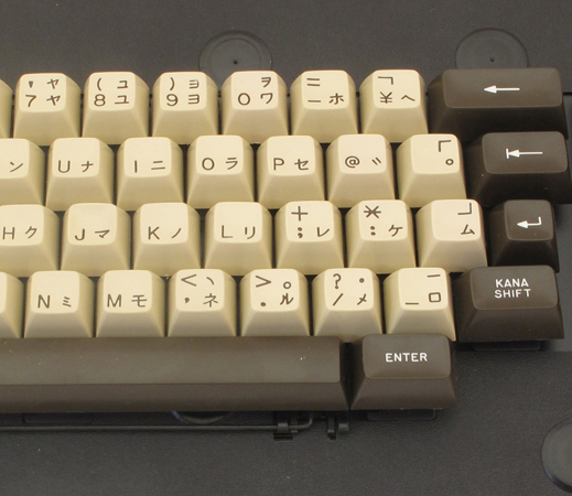

I got this Cortron/Licon keyboard (ITW magnetic pulse switches?) with Japanese double shot keycaps, made in Dec. 1980. (NOS)
It has an IBM 3270 layout, so it was probably used on a 3270-compatible terminal.
The switches are linear, quite smooth - Honeywell hall effect in feel but with a bit of a "clacky" noise coming from the keycaps when bottoming out and releasing, which I like. The keycap material feels a bit cheap though.
The PCB is an unusual shade of tan:
Notice the Licon logo. It is "Made in USA" - strange for a keyboard with Japanese keycaps. Licon also made keyboards for UNIVAC.
There is a protruding thing on the back of the PCB, which I assume is a solenoid:
The "P" key isn't working properly. Probably the spring in the switch is snagged on something. So it looks like I'll have to de-solder that switch, open it up and fix it. When I do, I'll post my first "switch dismantle" photos. (didn't want to, but now I have no choice)

In the second pics, some of the alpha caps look engraved. Is that contributing towards the feel, or is it entirely in my imagination?

I think it's entirely your imagination.
Never mind. I figured it out. I had to push the two sides in, through the holes in the side of the case.
I was right. The spring had slipped off its mount and was jammed. It works now.
Edit: No, I was wrong. It has nothing to do with the spring. The pins on the centre part can push in and when they do, it causes the sliding magnets to jam. That's going to make it a real fucker to get this back in the keyboard without pushing the pins in too far.
Whew. I did it. There was lots of swearing and I burnt my hand again, but it's back in there and working.

Interesting. I like the dual shift keys for Kana and Latin shift.

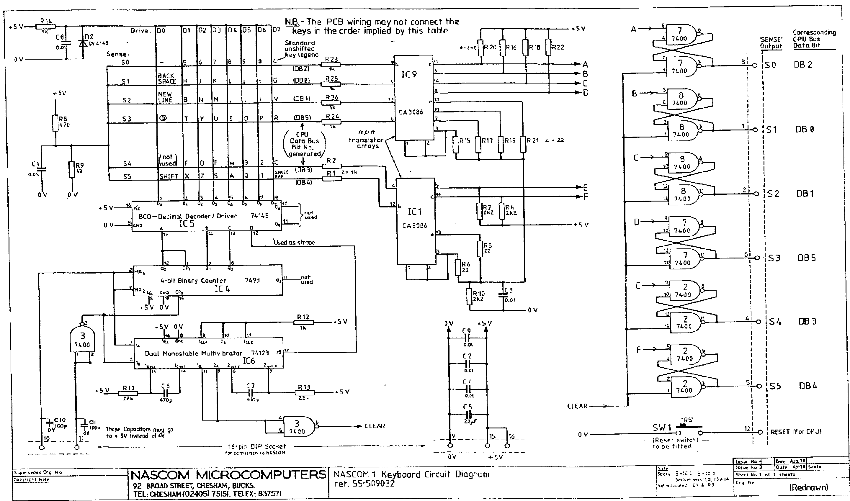

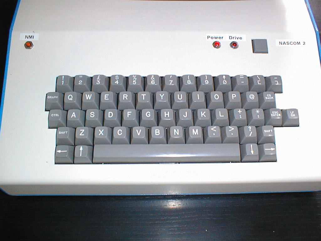

I used a Licon keyboard for years, easily the best keyboard I ever had. It was on a Nascom 2 computer (UK built Z80 based micro from the eighties). The capactive transfer switches have fantastic feel, far superior to the cherry browns I'm bashing at the mo).
I have a circuit diagram of the Nascom keyboard which I've attached. It shows the interface between the physical keys and the parallel port the keyboard was attached to. I know there was some sort of 'scanning' routine in the monotor that sent pulses out through the port and read back states (basically a keyboard matrix). I'm sure a simple circuit could be made to to do the same, maybe using an Arduino to do the scanning and generate modern PC key codes. See attached...
