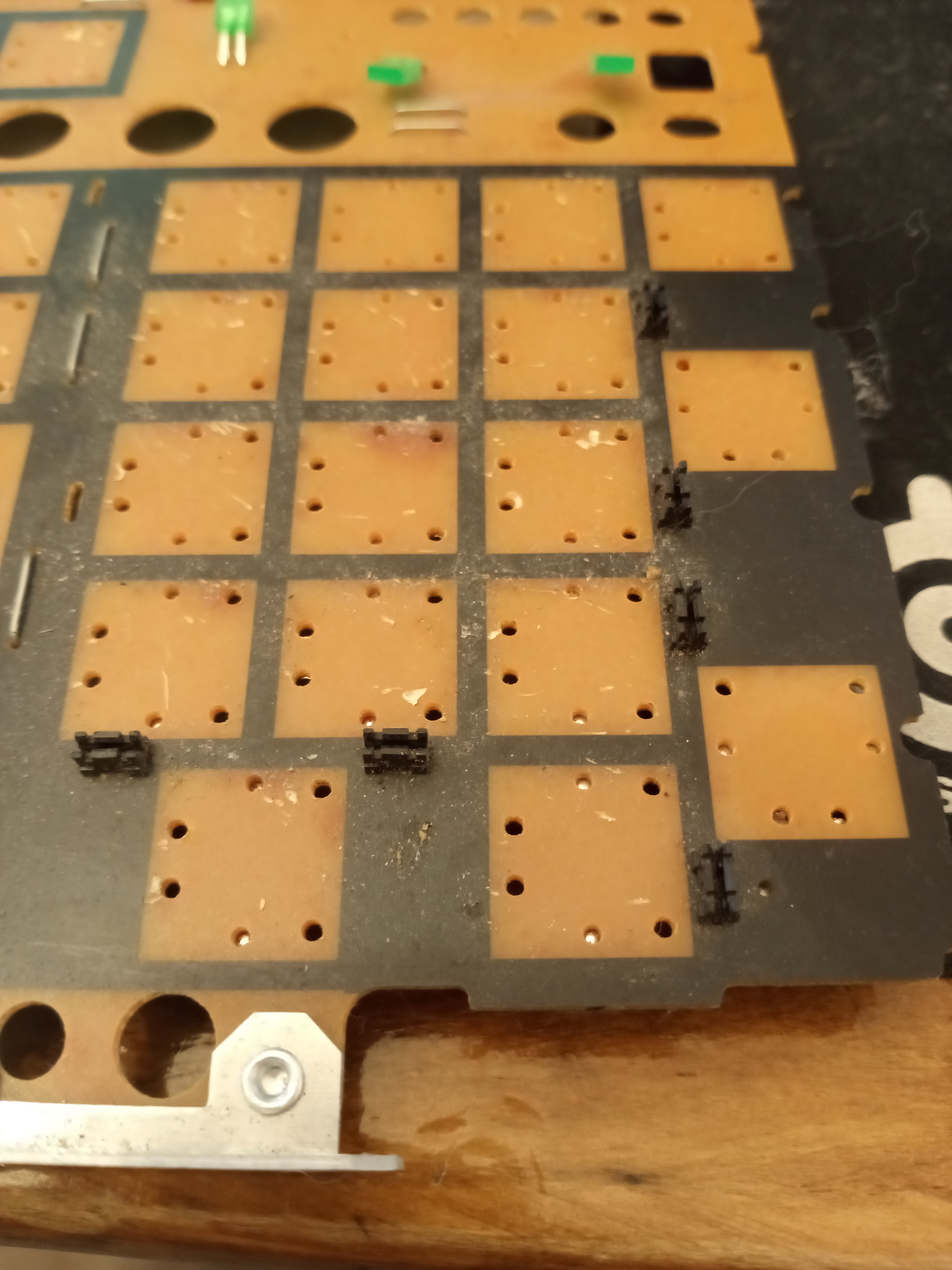

Snacks, I got a question for ya...making my own (much simpler) plate spring build/pcb, and I am planning on using pcb-mount switches. How would I handle stabilizers? Do these just use normal Alps stabs? How do I add those to the PCB? Thanks

Hmm, that's a interesting question, and it's really going to depend on what your specific plans are. For me, I took everything from a keyboard that had plate mounted switches, so I didn't really give it any thought at the time. But if you're using PCB mount, I believe you have two options:kelvinhall05 wrote: 21 May 2020, 03:06 Snacks, I got a question for ya...making my own (much simpler) plate spring build/pcb, and I am planning on using pcb-mount switches. How would I handle stabilizers? Do these just use normal Alps stabs? How do I add those to the PCB? Thanks![]()
#1. Use whatever mechanism PCB mount APS keyboards use (I'm sorry I don't know
#2. A different approach for doing the build with the PCB mounted switches is to still have a plate. The switches aren't clipped in, since they don't have clips. But you'd add aligned cutout holes between the PCB and plate in order to do a bolt mod. I like this approach for a few reasons. First of all, a plate feels nice IMO. It also enables you to have plate mounted stabilizer clips. Here is an example from user Delirious

Well I actually got a loose pcb mount switch in from SneakyRobb with an M0116 and loved it so much I just built a pcb around it. I already had a PCB made ("focus58"; focus layout, wkl, 60%, Alps SKCM/SKCL only) so all I did was make a copy of that, change the switch footprints, and reroute the traces.snacksthecat wrote: 21 May 2020, 06:54Hmm, that's a interesting question, and it's really going to depend on what your specific plans are. For me, I took everything from a keyboard that had plate mounted switches, so I didn't really give it any thought at the time. But if you're using PCB mount, I believe you have two options:kelvinhall05 wrote: 21 May 2020, 03:06 Snacks, I got a question for ya...making my own (much simpler) plate spring build/pcb, and I am planning on using pcb-mount switches. How would I handle stabilizers? Do these just use normal Alps stabs? How do I add those to the PCB? Thanks![]()
#1. Use whatever mechanism PCB mount APS keyboards use (I'm sorry I don't know). I'm pretty clueless as to what those boards used, but I'll look a bit online and see if I can find some info. Or someone else can chime in and drop some knowledge on us.
Did you harvest these things from a keyboard yourself, or did you buy everything in parts? Just wondering what option #1 might look like.
Anyway, it seems like I will likely only be able to use PCB mount, and I would love to be able to use the keycaps and stabs from a Focus 2001 or similar.

That's cool, but really wondering what options you have for stabilizers if that's the case. I mean, you could try cutting/drilling the PCB, but I don't have experience with that so can't say how difficult it is. Or you could glue the stabilizer clips to the PCB I suppose. It's a bit of a hack but would probably work fine. In any case, I look forward to seeing how it turns outkelvinhall05 wrote: 21 May 2020, 13:53 Well I actually got a loose pcb mount switch in from SneakyRobb with an M0116 and loved it so much I just built a pcb around it. I already had a PCB made ("focus58"; focus layout, wkl, 60%, Alps SKCM/SKCL only) so all I did was make a copy of that, change the switch footprints, and reroute the traces.

These are the stabilizers on the broken PCB P70 I got.
I could remove them and then model them for 3d printing from something like Shapeways.
The original ones are plastic melt riveted but you could have ones that clip in. That way they would be optimal height

Robb: *gives actual solution*
